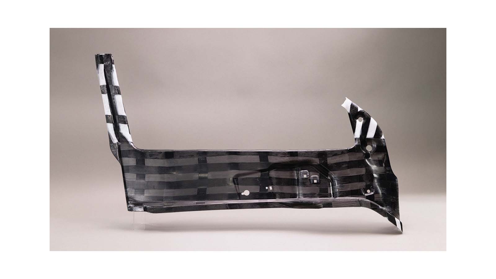

Composite lattice-reinforced polypropylene sheet
Image courtesy of Altair

Winners: WEAV3D, Braskem, and Clemson Composites Center for the cost-effective lightweight vehicle body structures
WEAV3D, Braskem, and the Clemson Composites Center developed a composite-lattice-reinforced polypropylene (PP) sheet (pictured above) that can be tailored to match the performance of any vehicle body structure on the market. Manufactured with a high-rate, highly automated forming cycle that produces more parts using less energy, the new sheet cost 50% less and reduces weight by 23% compared with CFPA6 organosheet (carbon-fiber-reinforced polyamide 6) and 60 to 70% compared with steel. The material also boasts a 62% reduction in trim scrap by weight. Lastly, compared to steel, the PP sheet features superior energy absorption and shape recovery.
