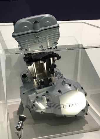

Motorcycle engine housing molded from phenolic resin compounds saves weight and reduces engine noise.

One such example is an engine housing for the BMW F650 water-cooled single cylinder (650-cc) motorcycle engine. Current die-cast from aluminum, switching to a phenolic compound would reduce the engine’s overall weight (including the mass of the cylinder) by 14–28%, while thermal efficiency would also be improved and engine noise would be reduced by 5 dB. Engine performance is equivalent to an aluminum engine housing.
According to the project leader at Fraunhofer, Lars Fredrik Berg, the technology has further potential: “Besides cylinder housings and engine blocks, fiber composites such as Sumitomo Bakelite’s high-performance composite materials can be used in many other components in the drive train, to reduce weight and improve overall performance.” The materials are also opening up new possibilities in component design: “We are just starting to explore a range of new benefits and options which would not be possible with aluminum,” Berg explains.
