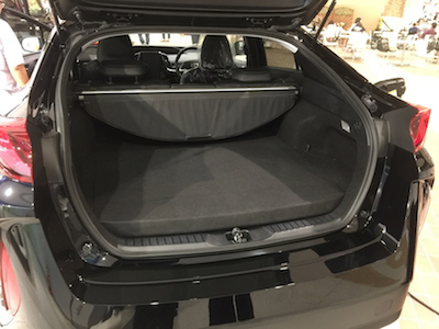

The solution, based on a thermoplastic honeycomb core technology developed by EconCore, is implemented in the trunk cover of the car latest Prius PHV hybrid from Toyota. Japanese processor Gifu Plastic Industry Co. licensed technology from EconCore to produce the part. Due to its combination of strength and rigidity and optimized material performance, the ultra-low weight ThermHex honeycomb delivers weight savings of 50% as a core part inside the trunk cover compared to previous conventional material set-ups based on cardboard and metal.
Honeycomb material is used in the trunk cover of the new Prius PHV.
This specific trunk cover part was developed by Gifu Plastics together with its local automotive supplier partners. Gifu Plastic developed capabilities and products to conform to the specifications of automobile parts including durability, heat resistance and cold resistance.
