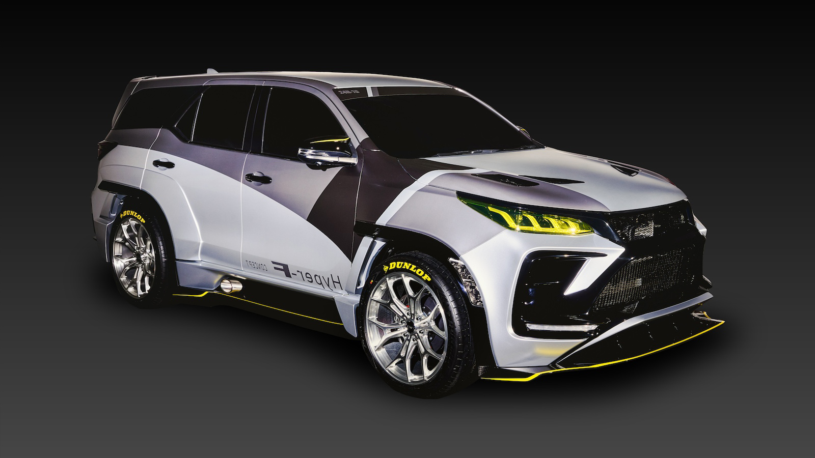

Materials developed by Mitsui Chemicals and subsidiary Arrk Corp. have been employed in a high-performance concept car based on the Toyota Fortuner. Direct pellet-fed 3D-printed components, jointly developed by Mitsui Chemicals and Arrk, and Tafnex CF/PP unidirectional carbon-fiber-reinforced polypropylene (PP) sheet developed by Mitsui Chemicals have found application in the Toyota Hyper-F Concept designed by Bangkok-based TCD Asia.
Tafnex CF/PP has been used for decorative components on part of the front bumper and the hood air vents, while the direct pellet-fed 3D-printed components are fitted to the hood air duct bezels.
Materials enable lightweighting.
The Toyota Hyper-F Concept is a high-performance model with a styling design that incorporates the road handling and aerodynamic performance cultivated in the racing field by TCD Asia’s motorsport business. The new materials have enabled the company to further reduce the concept car’s weight. In addition, the fitting of four sport seats instead of two provides a unique user experience.
