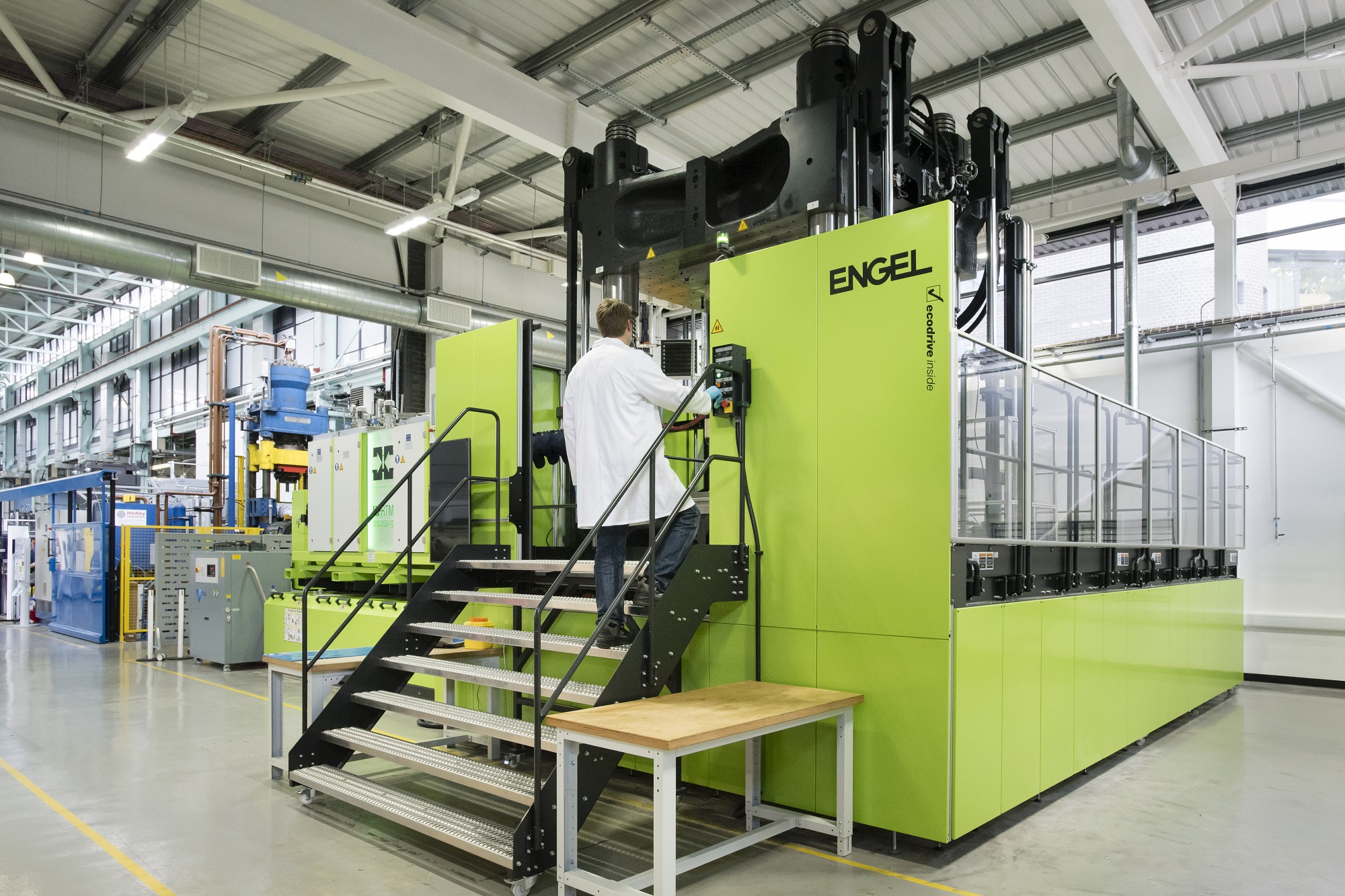

Great Britain's first Engel v-duo press has been housed at WMG's Automotive Composite Research Centre at the University of Warwick. Engel supplied the 1,700-tonne press with a mould and integrated HP-RTM equipment.
The Engel v-duo machine was designed specifically for fibre composite applications. Compared to conventional presses, the Engel v-duo is 50 per cent shorter in terms of height.

Engel supplied the 1,700-tonne press with a mold and integrated HP-RTM equipment. With a mold mounting surface of 2.2 by 1.8 meters, the machine offers WMG the opportunity to produce a multitude of components and use different materials and manufacturing processes.

The Engel v-duo machine was designed specifically for fiber composite applications. Compared to conventional presses, the it is 50 per cent shorter in height and about 60 per cent lighter. The large vertical machine, which is available with clamping forces from 4,000 to 36,000 kN, therefore makes it possible to create compact production cells at low investment costs.
The Engel v-duo is characterised by a very high degree of rigidity and excellent platen parallelism. Platen-parallelism control for injection compression moulding is included in the standard version of the machine. In addition, handling devices that move straight into the mould area can be integrated to save space. Using the sliding tables, insertion tasks and set-ups can be carried out flexibly and easily. The hydraulic accumulator has been done away with completely, and with the ecodrive servo-hydraulic system fitted on the standard version of the machine, the Engel v-duo is setting new standards in energy efficiency too.
