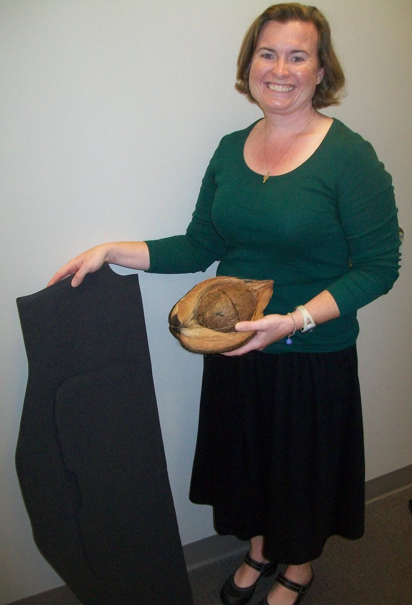

Ford's Elizabeth Johnston shows a load floor made with a coir-filled compound.

Ford is using coir to replace cotton shoddy in a polypropylene compound in the 2012 Focus Electric load floor, Elizabeth Johnston, advanced green engineer, told PlasticsToday in an interview. Ford calls the new material "cocofelt".
"Acoustic properties are the exact same as those with cotton shoddy," Johnston says.
The compound is a 50/50 mix of coir and polypropylene. Material from 1-2 coconut husks is used per part. Coir is a waste product that is not used for fuel because of its high ignition rate. It's abundant, says Johnston, and has "great inherent properties", including bending stiffness, ignition resistance, moisture resistance, microbial resistance and low odor.
The polypropylene acts as matrix glue, has a low density, and has an overall good performance-to-cost ratio.
She says that Ford's suppliers make sure that child labor is not used to collect the coconut husks, which are widely available in tropical areas. She also says Ford plans to expand applications for coir. It's slightly more expensive than cotton shoddy.
Johnston told PlasticsToday that the supply chain works like this: The coir fiber (from Natural Composites) and synthetic thermoplastic non-woven fabric is produced at Hobbs Bonded Fibers (Waco, TX) by carding and needle-punching a coconut fiber-based nonwoven material. The material is then run through a calender in-line to achieve a 6mm thickness. The finished non-woven material is sent to Aftech (Advanced Fabricating Technologies LLC; Rockford, MI) to die-cut into the shape for the part, and assembled with a hardboard layer and finishing carpet. Swiss automotive systems supplier Autoneum is the final supplier.
