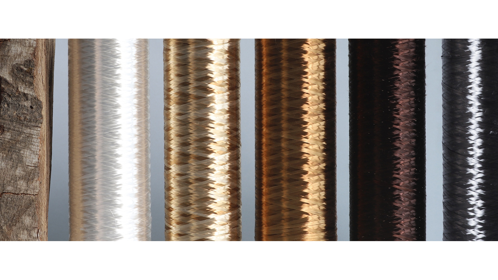

Germany's Technikum Laubholz has opened pilot plant to demonstrate its process for synthesizing carbon fiber from local hardwood resources.Image courtesy of Technikum Laubholz
Independent German research institute Technikum Laubholz has opened a state-of-the-art pilot plant to demonstrate its process for synthesizing carbon fiber from local hardwood resources. The institute was founded in 2020 through the initiative of the state of Baden-Württemberg under the auspices of the Ministry of Food, Rural Affairs, and Consumer Protection.
Dubbed WDBSD CF, the wood-based carbon fiber is made using an energy-efficient process that stabilizes the fibers at lower temperatures and in a shorter time than when producing carbon fibers from fossil-based raw materials. This reduces both energy consumption and production costs, supporting sustainability goals. Further, the use of direct spinning techniques for cellulose fibers further reduces operational costs and environmental impact.
