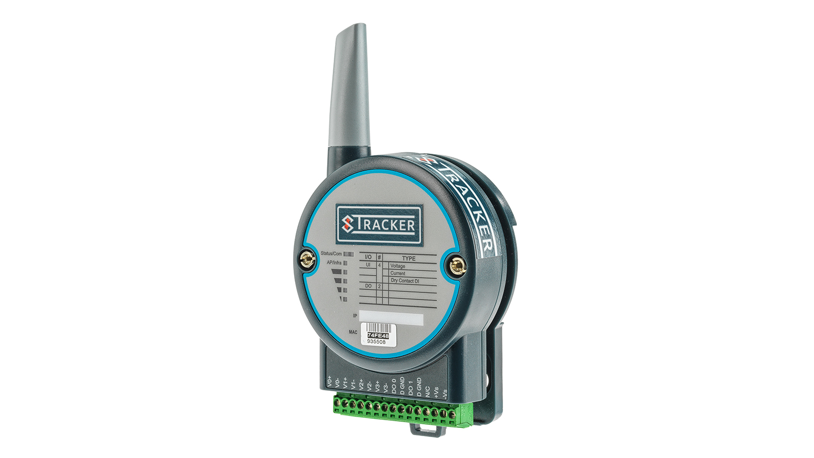

The Tracker allows users to monitor a variety of injection molding process parameters.Image courtesy of Wintriss Controls
Wintriss Controls Group is introducing hardware to complement its ShopFloorConnect overall equipment effectiveness (OEE) and production tracking software.
The Acton, MA–based company designed the Tracker to streamline and optimize data collection while minimizing operator involvement. The device allows users to monitor a variety of process parameters, offering a selection of pre-programmed digital inputs such as run/idle and counting, along with analog inputs for temperature, pressure, flow, voltage, and electrical current.

The Tracker is WiFi-enabled and pre-configured for seamless integration into both new and existing ShopFloorConnect installations across a range of machines.
Device eliminates manual entry tasks
This cost-effective solution automatically collects critical data without requiring manual entry of job information or downtime reasons. For example, an injection molding department using ShopFloorConnect to track uptime, downtime, and OEE can now add a Tracker device to each machine. The device can be connected to a temperature sensor on one analog input and a pressure sensor on the other. If either parameter falls outside an acceptable range, the Tracker triggers an output connected to an alarm.
