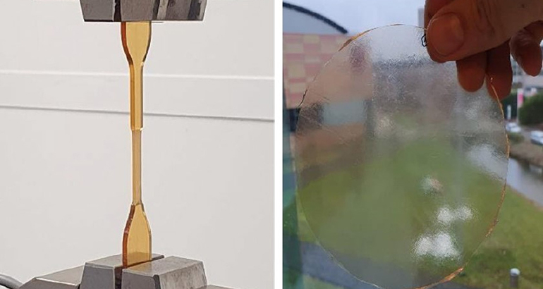

tensile testing of materials
Tensile testing of bio-based polymer (left) and a sample of polymer film.Image courtesy of Van 't Hoff Institute for Molecular Sciences, University of Amstedam
