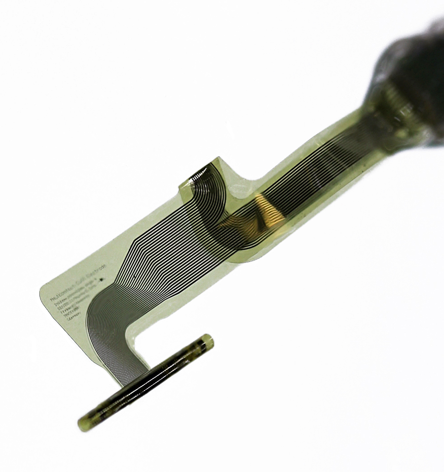

freiburg-implantable-cuff-300.jpgThe 20-mm-long (0.79 in.) cuff wraps around the vagal nerve in the neck, which "exchanges critical physiological information between the brain and other major organs, including the heart," writes Susan Young Rojahn in MIT Technology Review. Fitted with 24 electrodes, the device identifies the electrode that is closest to the nerve fibers that transmit the blood pressure signal to the brain. The electrode then stimulates a change in blood pressure without affecting any of the other fibers.
"Our cuff consists primarily of plastic—more precisely polyimide," Dennis Plachta from the university's Laboratory of Biomedical Microtechnology, Department of Microsystems Engineering, told PlasticsToday. "This material is not really new to implants and neuro-electronic interfaces, but it is advancing fast because of its key features, he explains.
"Thin-film technology allows superior density of active components due to highly miniaturized structures and it is flexible, reducing stress to the tissue," says Plachta, adding that his department has a long history developing designs and processes involving polyimide electrodes.
In animal tests conducted by Plachta and fellow researcher Thomas Stieglitz, also from the department, the device achieved a 30% reduction in mean blood pressure without causing any noticeable side effects. The findings have been published in the Journal of Neural Engineering.
