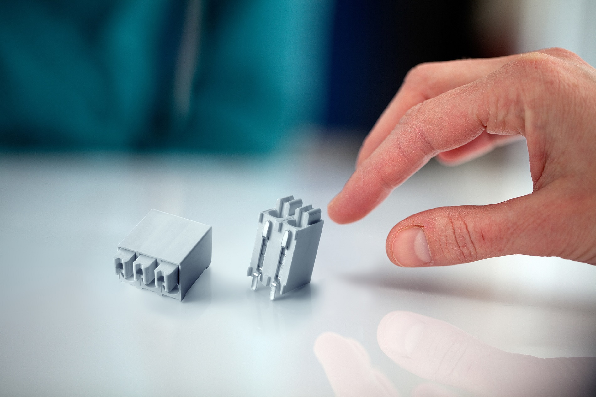

Molders of terminal blocks widely employed in industrial machinery, automation, transportation and building infrastructure can now turn to a halogen-free solution in the form of a high temperature polyamide (PA) 4T delivering UL94-V0 flame retardancy combined with outstanding thermal and mechanical performance. Stanyl ForTii T11 is supplied by DSM Engineering Plastics (Singapore). This halogen free formulation has been designed to meet the stringent regulations and high performance requirements for printed circuit board (PCB) terminal blocks that are mounted using surface mount technology (SMT) and allow the PCB to connect to external devices.

Stanyl ForTii T11 has been approved or is currently under test at leading terminal block producers. For example, WECO Contact GmbH (Hanau, Germany), a leading global supplier of surface mount devices, decided last year to use the advantages of Stanyl ForTii T11 for all terminal blocks as well as pin strips in its SMartConn product range. Its latest product, the 830-A-111-SMD terminal block, with a pin pitch of 3.5 mm and a total space requirement on the PCB of just 97 mm², offers high performance in a very small space. It is said to be ideally suited for reflow soldering, and with its white Stanyl ForTii T11 housing, it is ideally suited for use in the lighting industry. WECO says the new terminal block represents the perfect combination of the new high temperature resistant material with highly sophisticated connection.
