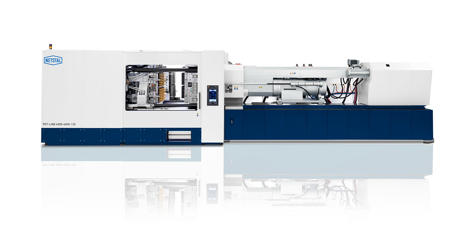

The design of KraussMaffei's new Netstal PET-Line has been optimized to effectively process recycled PET. Image courtesy KraussMaffei. |
A dynamic five-point dual toggle lever operates within the fully electric clamping unit. Lock-to-lock time at 4,000 kN clamping force is 1.9 seconds. Output is increased further through shorter cycle times. “Thanks to the particularly smooth, high-precision kinematics of the clamping unit, reliable and mold-friendly operation is guaranteed under production conditions,” said Kleinfeld. The machine also is the most energy efficient that KraussMaffei has developed. Up to four post-mold cooling stations can be installed, and efficient interior and exterior cooling ensures a consistent premium and uniform preform quality.
