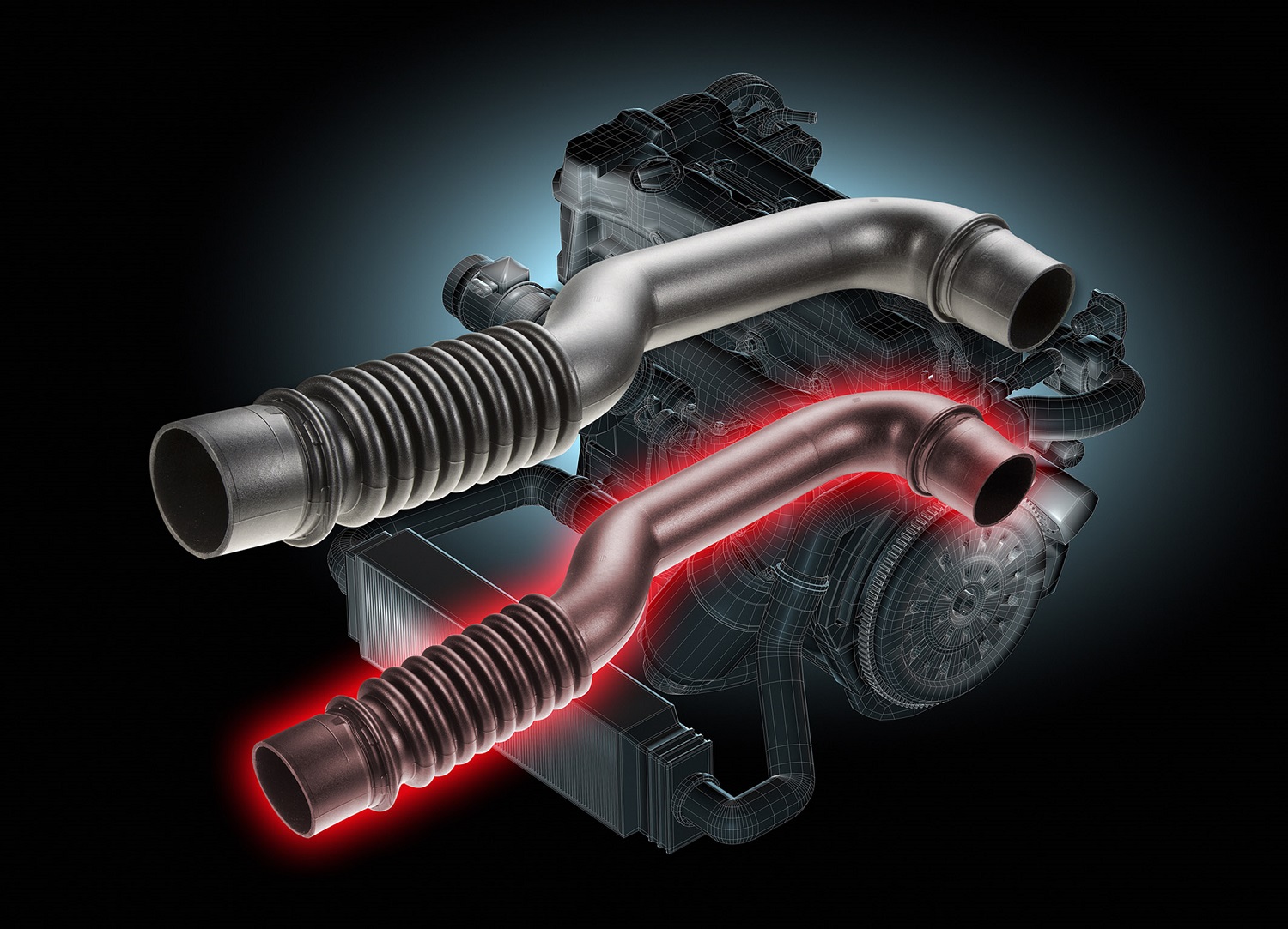

Blowmoldable PA 66 takes on turbocharger challenge.
From injection molding to blowmolding
In 2012, one of the first serial applications for the injection molding grade Ultramid Endure D3G7 was the substitution of a heat shield in the charge-air duct which had previously been metallic. With its temperature resistance of 220°C in continuous use and peak temperature loads of 240°C, the material can also be used for other components behind the turbocharging such as in the resonator, in sensors and actuators, on the intake side of the intercooler, and in the charge-air manifold. The pipes between the turbocharger and intercooler which are subjected to the same high temperatures can best be manufactured by blowmolding with the new Ultramid Endure grade.
The new Ultramid Endure D5G3 BM with a glass fiber content of 15% shows a high heat-aging resistance, is easy to process, and has outstanding acoustic properties. As with the injection molding grade, the temperature resistance is 220°C during continuous use and the possible peak temperature is 240°C. The relatively low melt temperature during processing with blowmolding generally results in favorable system costs. On this account, Ultramid Endure performs significantly better than, for example, polyphenylene sulfide (PPS).
