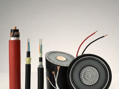

Borealis and Borouge are expanding their existing portfolio of flame-retardant jacketing grades with the launch of FR8101. Photo: © Borealis
