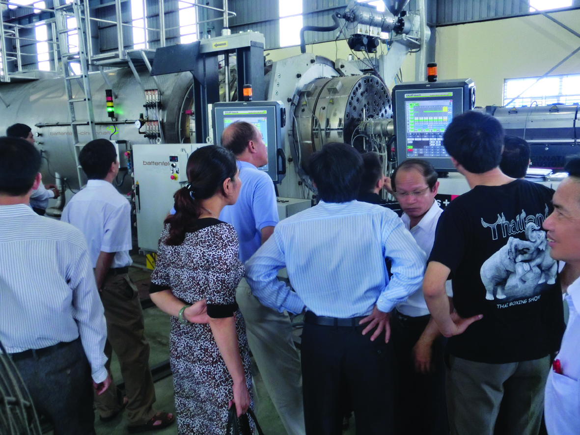

Among highlights shown by Tien Phong Plastic was its new KryoSys pipe line for large diameter polyolefin (PO) pipe extrusion. The open house began with the demonstration of a battenfeld-cincinnati 1200 mm GreenPipe (energy efficient) extrusion line with a maximum output of 1400 kg/h, producing pipes for water and sewage applications with a wall thickness of 57.2 mm. This was followed by technical presentations illustrating the process and materials, presented by Tien Phong, battenfeld-cincinnati Borouge and Mitsubishi.
The showcased GreenPipe extrusion line consists of a monos+ 90-37D single screw extruder with AC motor, a KryoS 63-1200 pipe head, a CE 30 co-extruder for color stripes, and the necessary downstream equipment for pipe sizes up to 1200 mm: two vacStream 6 m single-chamber vacuum tanks, two coolStream 6 m cooling baths, a pullStream haul-off with 10 caterpillars and a cutStream swarfless planetary cutting unit.
According to battenfeld-cincinnati, the internal melt and pipe cooling system employed in its KryoSys extruders enables a reduction in cooling length of almost 50% compared to a conventional extrusion line. Despite the short cooling length, sagging effects also are said to be reduced due to the internal melt cooling already in the die head.
The KryoSys system was first introduced in 2008. Its main feature, the KryoS pipe head, is based on a spiral mandrel die and comes with a special melt cooling system that makes it possible to start cooling the melt in the die. In the system the pipe itself is cooled simultaneously from the outside and the inside by a combination of water and air cooling.
