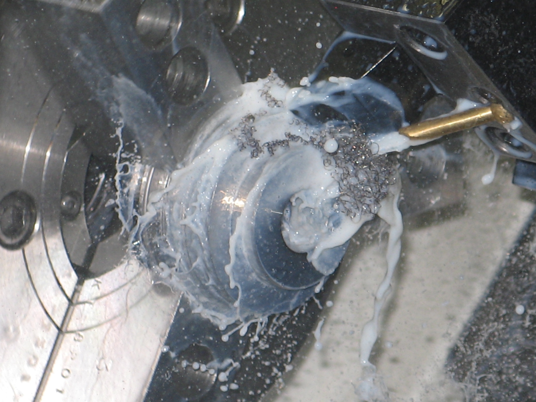

In high-speed machining, the heat is dissipated into the chip, so the chips need to be separated from the workpiece, leaving minimal heat in the work piece. Flood cooling is often used for large depths of cut to remove the hot chips from the workpiece. "In some situations, machinists still use liquid coolant or mist, which aids in the lubrication process but doesn't get the chips out of the way, so we recommend that people use liquid coolants on finishing pieces - it doesn't cool anything down but offers lubricity," said Walter Stuermer, sales manager for Millstar, a maker of precision milling tools.
Stuermer notes that there is a whole range of issues surrounding cooling fluids, pointing to "the whole environmental factor" as one major one. Additionally, he said, "It's messy. There's the cost factor - not just for the fluids but it adds maintenance because it's more difficult to keep the interior of the machine clean. It stinks. And it's harder to see what's
An illustrative of Wet Machining
going on if there a lot of coolant flooding the workpiece," he said. "In the mold industry, where they are working with close tolerances and intricate work pieces, people like to see what's going on."

Dry and near-dry machining is one answer
One answer to this ongoing problem of coolants is dry or near-dry machining, also referred to as Minimal Quantity Lubrication (MQL), which has gained in popularity in shops that want to minimize the costs associated with wet machining. Neil Canter, head of his own consulting company - Chemical Solutions - said that while dry and near hasn't replaced wet machining in all applications, they do provide some alternatives in some niche applications. "There are certain applications where heat can be dissipated in other ways besides wet machining, but in other applications it doesn't have a prayer because the heat will destroy the workpiece," Canter said.
He explained that near-dry machining involves using a lubricant aspirated in a filter, however, it's not suitable for high-speed machining. "MQL has its issues as well," Canter noted. "You can't make a lot of parts in a short period of time and you can't get rid of the chips. In high- speed, high-feed machining operations, near-dry just doesn't work. Dry machining is probably never going to take off. Some machines will do it for end-milling applications where the heat is easily dissipated. It has a niche."
