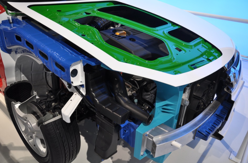

Front-end module of Changan's CX30 molded from LGFPP.
