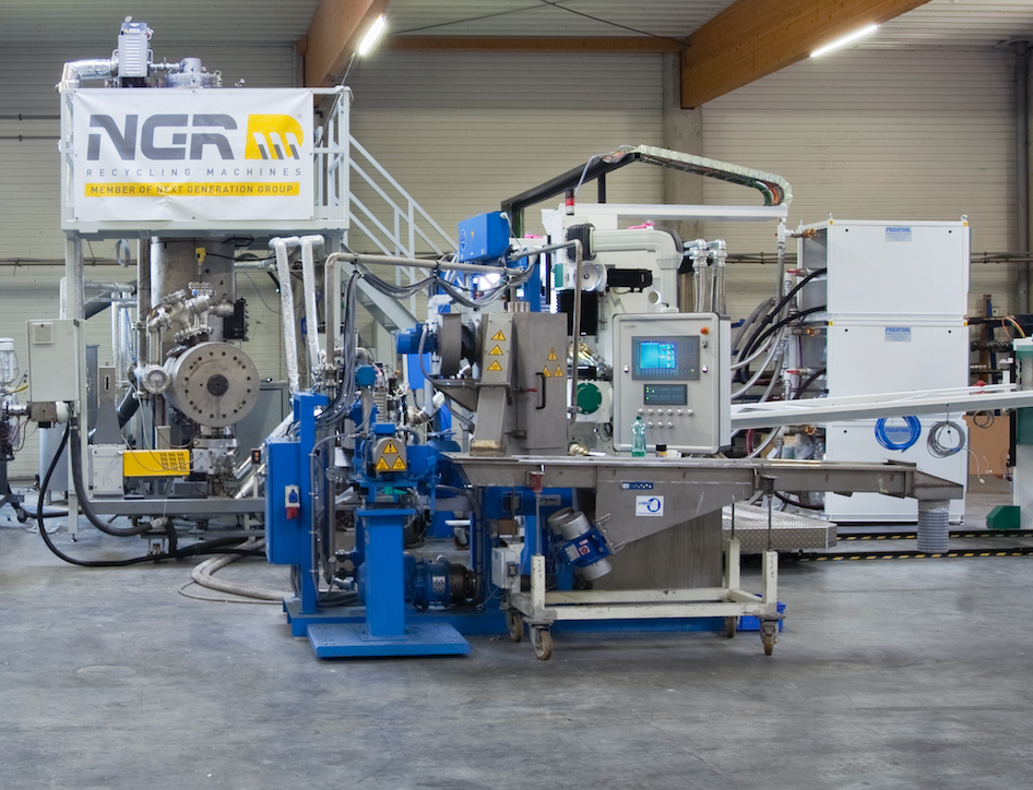

The system comprises a shredder-feeder-extruder combo for producing the plastic melt, a P:REACT unit for improving PET quality and a tight-tolerance sheet unit from Kuhne.

Next Generation Recyclingmaschinen GmbH (NGR; Feldkirchen an der Donau, Austria) and Kuhne GmbH (Sankt Augustin, Germany) have entered into a collaboration to produce PET sheets made from PET waste that match the quality of sheets made from virgin materials. The integrated system comprises a shredder-feeder-extruder combination for producing plastic melt, a P:REACT unit for improving the quality of PET and a sheet system from Kuhne for producing PET sheets with tight tolerances. Both PET sheet producers and thermoformed part manufacturers will benefit from the technology, according to the companies.
The shredder-feeder-extruder system can convert any form of incoming material into high-quality melt. This makes it possible to feed the unit with low-cost PET scrap, including punch scrap, sheet production scrap, bottle flakes and even fibers.
The PET melt is then decontaminated through P:REACT technology from NGR, which was introduced at NPE 2015. P:REACT is based on the principles of liquid state polycondensation, a process that considerably enhances the material properties of PET, according to the company.
As the molten PET enters the vertical part of the P:REACT, strands are formed to create a suitable surface-to-volume ratio. The material is then collected in a horizontal drum and slowly pushed forward. Post condensation starts immediately when the strands are formed and continues until the PET has exited the P:REACT. The P:REACT uses the melt energy for post condensing PET; the reactor itself only maintains the heat level. P:REACT is therefore highly energy efficient, which results in low operating costs.
The rise in intrinsic viscosity (IV) is controlled by the residence time of the molten PET inside the reactor, and machine parameters automatically adjust to achieve the desired IV at a consistent level within a small tolerance band. The continuous operation of P:REACT yields recycled pellets within a narrow IV range, suitable for use in such high-end applications as fiber spinning or sheet extrusion.
