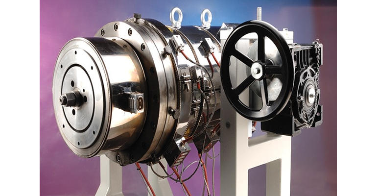

  • Single- and multi-layer pipe extrusion dies are optimized to different material types and pipe-diameter ranges of 2.5, 4.3, 6.2, 9.8, 15.7 and 24.9 in. (63, 110, 160, 250, 400 and 630 mm). Each die is mounted on a movable, height-adjustable stand; internal die surfaces are polished and heat-treated. Interchangeable die pins and nozzles accommodate multiple pipe sizes. Multi-layer dies can extrude up to five layers in a single pipe.
