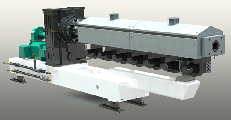

The new SHO extruder with groove-feed technology combines a space-saving design that delivers up to 20% higher outputs than existing groove-feed models. The SHO’s optimized feed section and energy-efficient DSB barrier screw are especially beneficial for high-viscosity, high-density polyethylene applications such as pipe extrusions, where lower melt temperatures, reduced power consumption, and improved energy efficiency are paramount, said Davis-Standard.
The new SHO series extruders feature next-gen groove-feed technology. |
“Improving energy efficiency equates to tangible savings for your operation while reducing your carbon footprint,” said John Christiano, VP Technology. “The SHO builds upon our existing groove-feed technology with a more streamlined, compact footprint and even greater performance in terms of output and energy savings.”
The SHO includes Davis-Standard’s next-generation gear case to optimize production space along with a streamlined hopper, low-profile power panel, and rugged base. It is available in sizes ranging from 2 to 6 in. (50 to 150 mm) with an L/D of 42:1.
