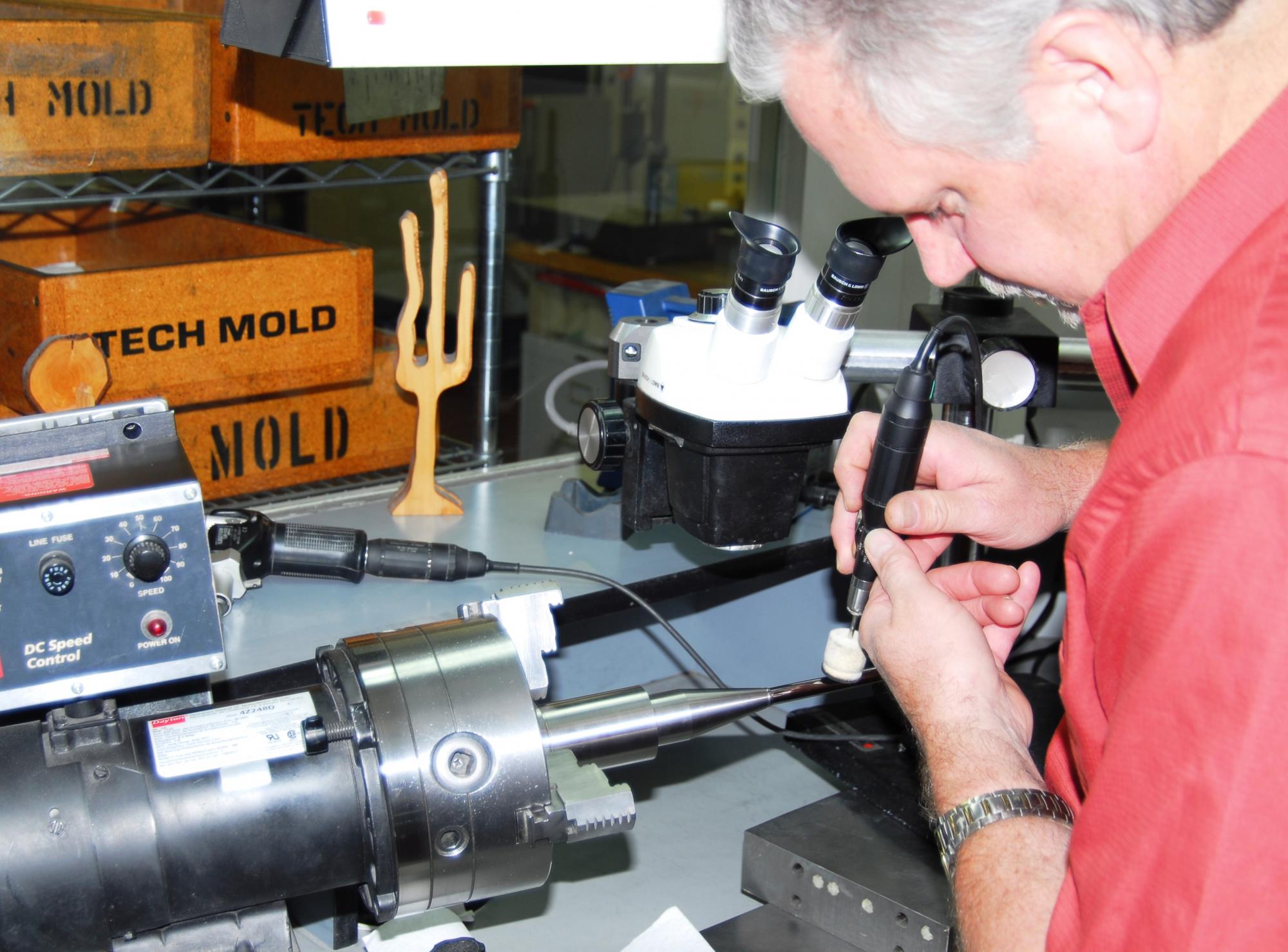

Mold polishing is perhaps one of the most critical phases of the mold build (and in mold repairs), and for decades it's been primarily a manual operation. Every mold company has one or two employees in a corner sitting under a bright light, bent over their work piece, painstakingly polishing with grinding stones, meticulously working with finer and finer abrasives until, micron by micron, the surface is perfect. This is time-consuming work and according to Karl Szanto, operations manager at injection mold manufacturer Tech Mold Inc. can represent as much as 8-12% of the total number of man-hours in a mold build.
Cores are expertly polished at Tech Mold. But soon maybe lasers can do much of a polisher's work, as shown in the photo below (laser treated part on the right).
