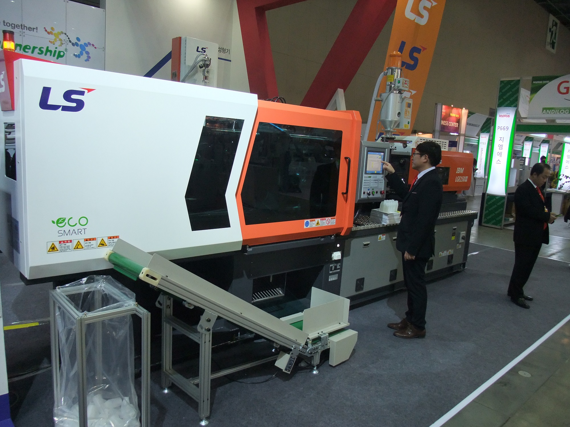

Case in point: LS Mtron, whose stand at Koplas was packed with a variety of injection machines demonstrating high-end processes and technologies. LS Mtron teamed up with material supplier Lanxess at Koplas to demonstrate back molding of polymer composite sheets on its new servo-hydraulic WIZ-1300X machine. The Tepex glass-reinforced polyamide (PA) sheets are heated to 210-240°C using an infrared heater before robotic placement in the mold and back-molding with PA. The part being molded at Koplas was a side impact bar.
LS Mtron also highlighted its Smart Pack System on its WIZ-500 two-platen injection press that employs a cavity pressure sensor and a nozzle pressure sensor to optimize mold filling. The machine was molding a 980-g polypropylene (PP) container box in a 35-s cycle time. The WIZ series claims energy savings of 40-75% versus standard hydraulic machines and a lower noise level of 75 dB.
Direct-long fiber thermoplastic (D-LFT) technology was also on show at the LS Mtron stand at Koplas, with an LGE80II all-electric press fed directly with carbon fiber to be incorporated into a polycarbonate matrix.
A surprise addition to the LS Mtron booth at Koplas was an all-electric injection blow molding machine, the LGE 150 III, molding bottles from high impact polystyrene (HIPS) in a 10-cavity mold with turntable rotation time of 0.7 s, which is 40% faster than a hydraulic type. "We are targeting food and medical packaging with this machine," says Yumi Kim, Senior Manager, Overseas Sales team, Injection Molding Systems at LS Mtron.
LS Mtron also debuted a hybrid (electric injection and hydraulic clamping) vertical injection press at Koplas. The LSV110 was molding a GF30% PA66 component with metal insert in a four-cavity mold in a cycle time of 35 s (25-g shot weight).
