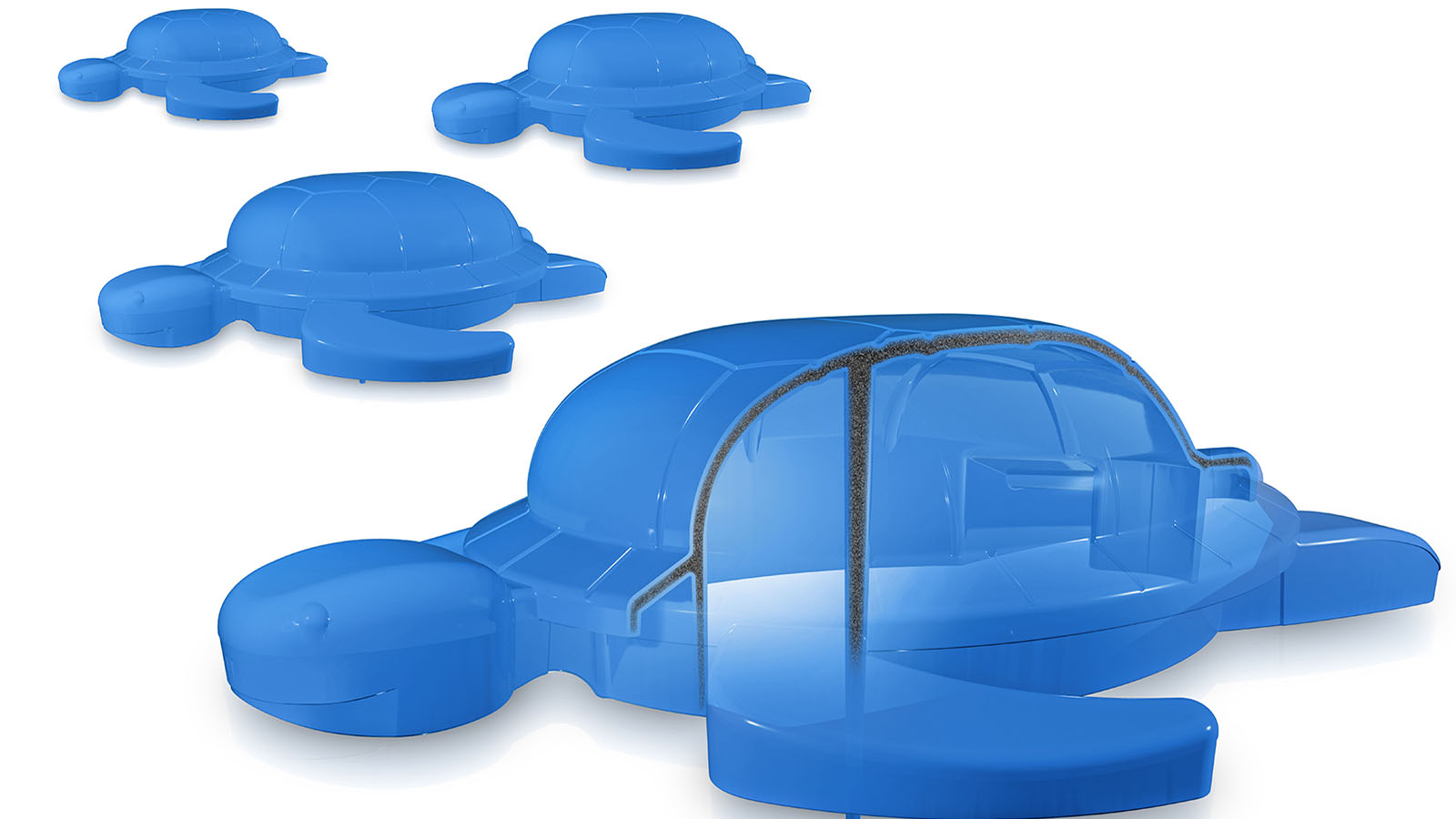

The blue turtle that will be molded at the international plastics processing trade show has a black core made of mechanically recycled PC/ABS and an outer layer made of chemically recycled ABS.
September 12, 2024
injection molded blue turtle
Image courtesy of KraussMaffei
Lightweight, with a glossy surface and a sustainable message, describes the small blue turtle that will be produced on an all-electric PXZ 121-380-180 Multinject press using the sandwich process at the KraussMaffei stand at Fakuma. It has a black core made of mechanically recycled polycarbonate/acrylonitrile-butadiene-styrene (PC/ABS) and a high-quality outer layer made of chemically recycled ABS.
