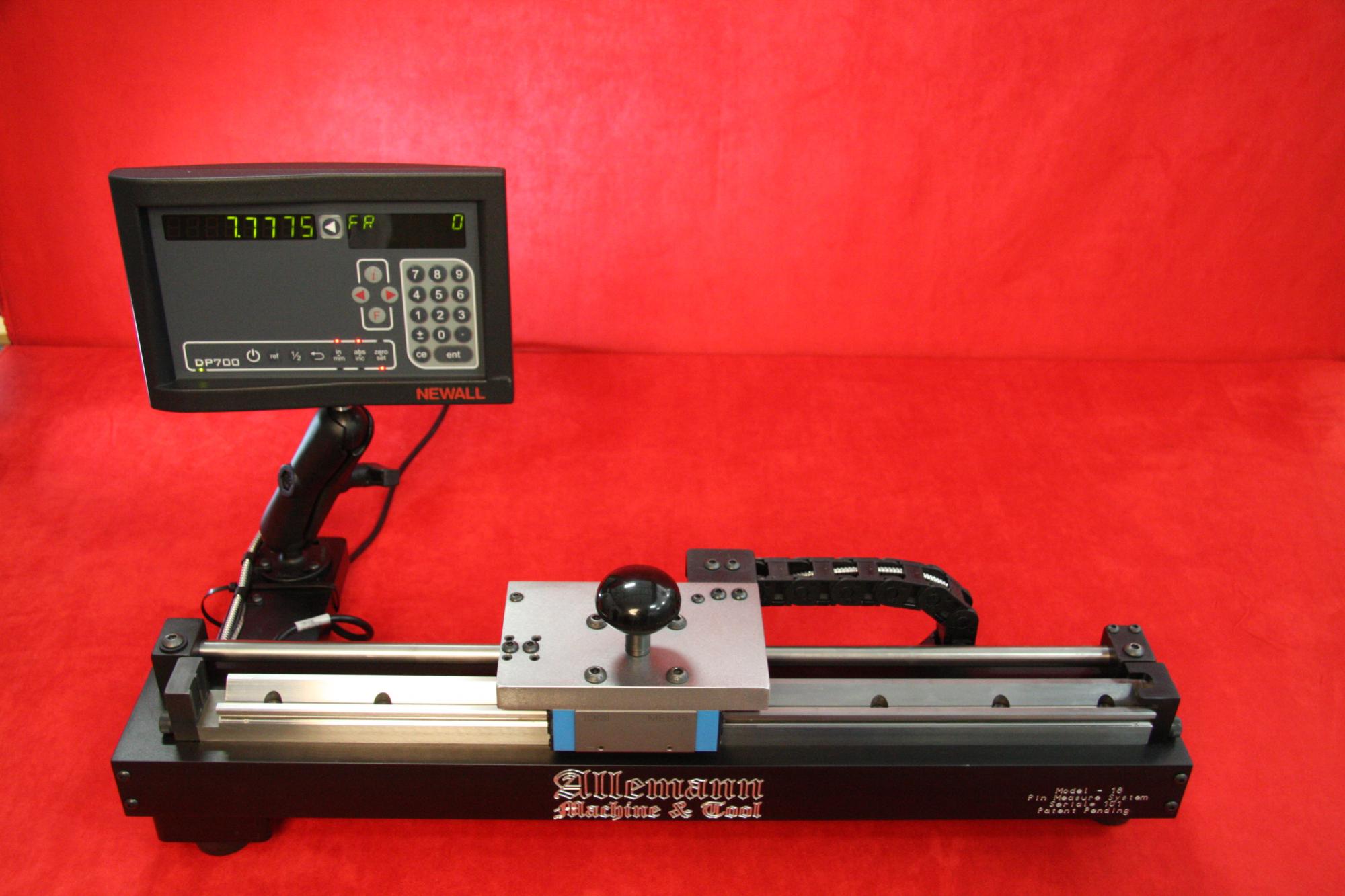

Moldmakers are a creative bunch and often come up with ideas for products to make their jobs easier. That's how moldmaker Terry Allemann along with his father, Jim Allemann, a moldmaker for 50 years, developed the idea for their new patent pending pin measuring system, a state-of-the-art device that increases accuracy and reduces cost in the pin measurement process.
The standard configuration of the pin measuring system is offered in both an 18" and 42" model with 1/8" to 1¼"+ diameter capacity. Custom sizes are available as special orders. All wear components are made from tool steel hardened to 60 RC of long life and durability. The pin measuring system also comes with replaceable anvils which allow using custom anvils for unique and difficult measuring applications. Available options include RS 232 cable for SPC output, as well as a beautifully finished oak box with a bi-fold lid to keep the pin measuring system from getting dusty and dirty. Measuring can be done with the instrument in the box.
IMG_4638_0.jpegThe measuring system incorporates the shop-tested Newall scale and readouts back by a five year warranty. The DP700 has the ability to measure in inch, metric, absolute and incremental.

Allemann's specialty business meant that obviously, they needed a good way to measure the length of all these different core pins, so the Allemann's developed the pin measuring machine. The oak box is an option because when Allemann originally built the first pin measuring systems, they kept getting asked how to cover it.
Allemann said that some of the benefits of the pin measuring system include the ease of use that allows anyone - whether a seasoned toolmaker or an entry level employee - to measure core pins accurately and consistently, and dramatically reduce labor costs and inspection time, while eliminating micrometer reading errors.
The system's unique design and small footprint allows the machine to be placed at the point of use in the production stream for constant and up-to-the-minute monitoring of the inspection process.
