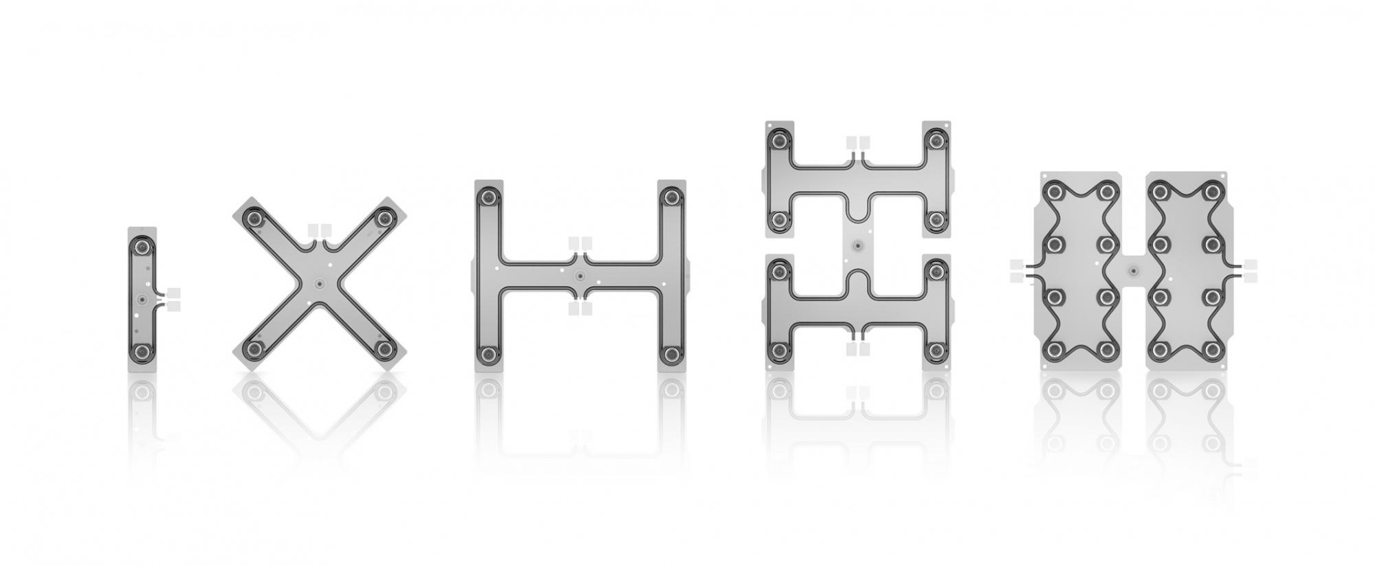

MHS Mold Hotrunner Solutions Inc. introduced a versatile and cost effective new line of hot runners for standard injection molding applications. Quick-Start manifold systems are pre-engineered with a focus on reliability, part quality, fast delivery, and a great cost performance, according to MHS. The new product family is specifically designed to complement the company's flagship, custom engineered Rheo-Pro series hot runners.
December 2, 2014
5 Min Read
New mold components make life easier for molders
MHS Quick-Start Hot Runners
"This is not a one size fits all business," said Kay Thielen, engineering manager at MHS. "MHS is committed to delivering engineering excellence to customers in all markets. Our Quick-Start and Rheo-Pro programs combined offer exceptional value and performance for a complete range of hot runner applications, from advanced solutions to common molding projects that require only a simple yet reliable approach."
Quick-Start manifold systems come in a wide selection of pre-designed configurations that feature the same high performance components found in custom engineered Rheo-Pro hot runners, like MHS' patented, front-removable nozzle heaters. There are many standard combinations available to choose from, for a large variety of common mold layouts. These designs have been optimized for ease of operation and maintenance in all markets. Every MHS hot runner system is 100% made in North America, from where it ships fully assembled and tested for fast, convenient mold integration. All Quick-Start and Rheo-Pro products are covered by MHS' warranty.
