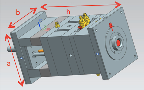

Figure 1A
Figure 1B
Figure 1C
Figure 1. Renderings A and B show the injection mold with a built-in force sensor (yellow), which records the ejection force after molding of the plastic part (Figure 1C). The dimension of the mold is a = 206 mm, b = 196 mm and h = 387 mm. The molded part has been optimised with four parallel fins on the inside to increase rigidity and prevent it from bending away from the substrate at the center and, thus, separate from the core surface when the part is pushed from the bottom during demolding. The molded plastic part is 69 mm long, and the contact area between the internal core and molded part is 31.7 cm2.
Figure 2. Click on image to view full-size version. Shown here is the response from the force sensor when pulling and pushing actions are performed, respectively. As the force meter is able to record positive and negative forces, it will be possible not only to measure the ejection force but also the force during mold filling.
The researchers ultimately observed that the optimised geometry made it possible to measure a huge and reproducible difference in the ejection force between, for example, a TPU part and core with and without the CrN SuperSlip (CrN-SS) coating from the Tribology Centre, as illustrated in Figure 3.
