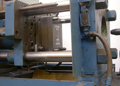

Image courtesy Glenn McKechnie/Wikipedia.
"Do you have the CAD mold designs and the mold simulations? Let's do an experiment on one mold. If it works, we can do it to all of them." Now I had my client's attention.
