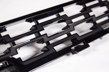

An automotive grille with molded-in colorwill be on display.
Among the new parts on display at RocTool’s stand will be parts molded from tooling made in collaboration with ABC Group (Toronto, ON, Canada) and Proper Tooling (Warren, MI), including exterior automotive grilles with molded-in color in multiple textures and a 100% recycled plastic housing. “Being able to get the best quality with 100% recycled materials is a great challenge and also a choice to turn to the most planet-friendly solutions,” said Jachen Mitzler, Head of Strategic Product Management at KraussMaffei.
