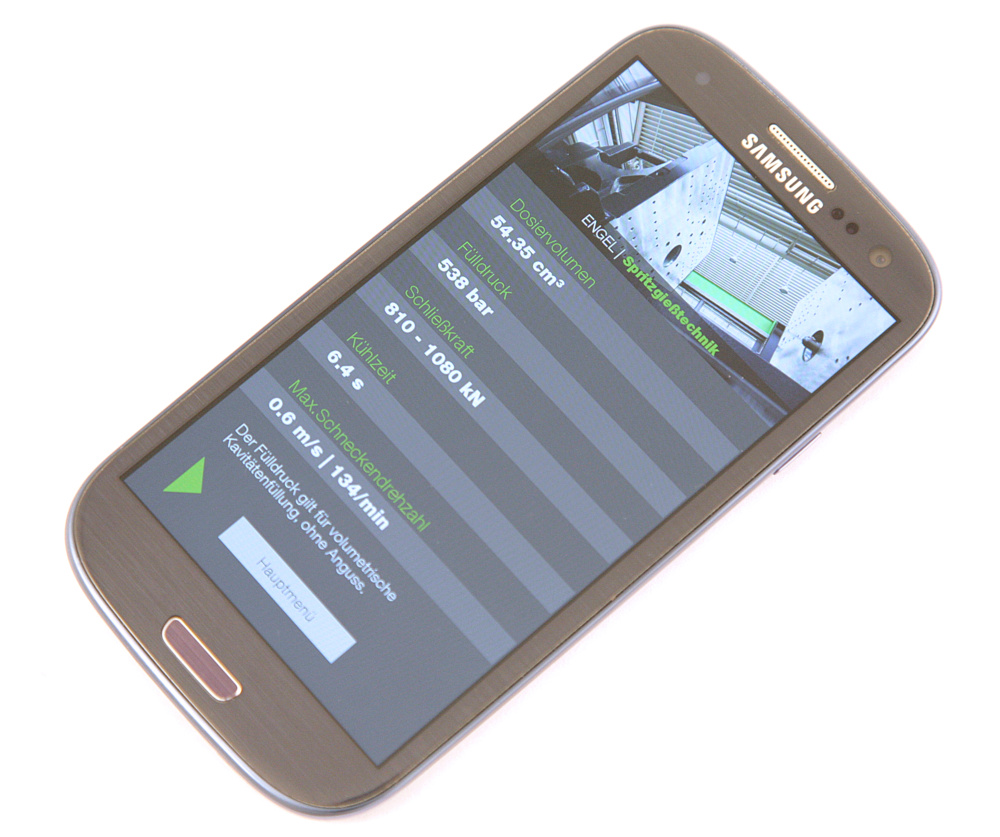

Engel, which had supplied customers with a slide rule for quick calculations, now has an app performing much the same function but in a decidedly more mobile format. The Austrian supplier of injection molding machines and automation said in a release that its e-calc app contains materials data for typical thermoplastics, including thickness factors, temperature conductivities, de-molding temperatures, permissible peripheral screw speeds, enthalpy values, and guidelines for processing loss.
Beyond machine setup calculations, Engel envisions e-calc as a new extension of its existing customer service and training offerings.
"We see great potential for our customer service, and in the long term for our training departments, in app technology," Wolfgang Degwerth, head of the customer service division at Engel Austria said in a release. "Thanks to e-calc, we have again simplified communication between Engel and our customers, and are now entering a totally new service era."
e-calc app is available for Android smartphones in German and English, with versions for iOS and Windows Phone under development.
