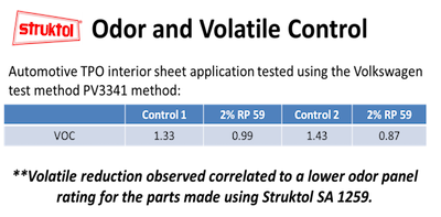

Struktol RP 59 is a blend of odor neutralizing chemistries and VOC absorbers intended for difficult, high-odor, and high-volatile content compounds. The product can be used in a variety of polymer resins but is also primarily targeted at polyolefins. RP 59 is very effective in packaging applications to not only reduce or eliminate odors in the packaging polymer but also absorb odors coming from the packaged product.
