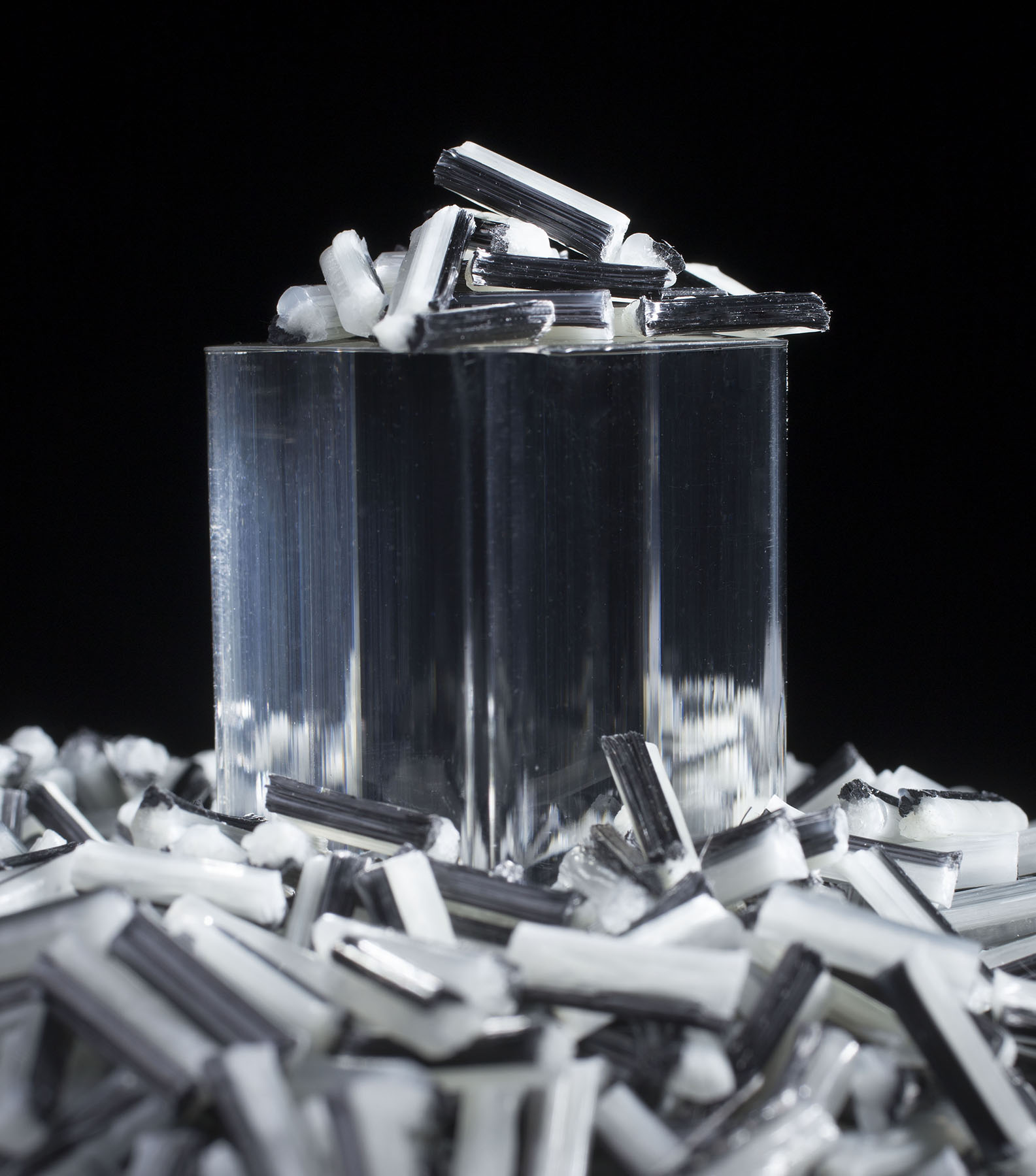

Using an appropriate balance of carbon
and glass long fibers can realize an appropriate cost balance.
