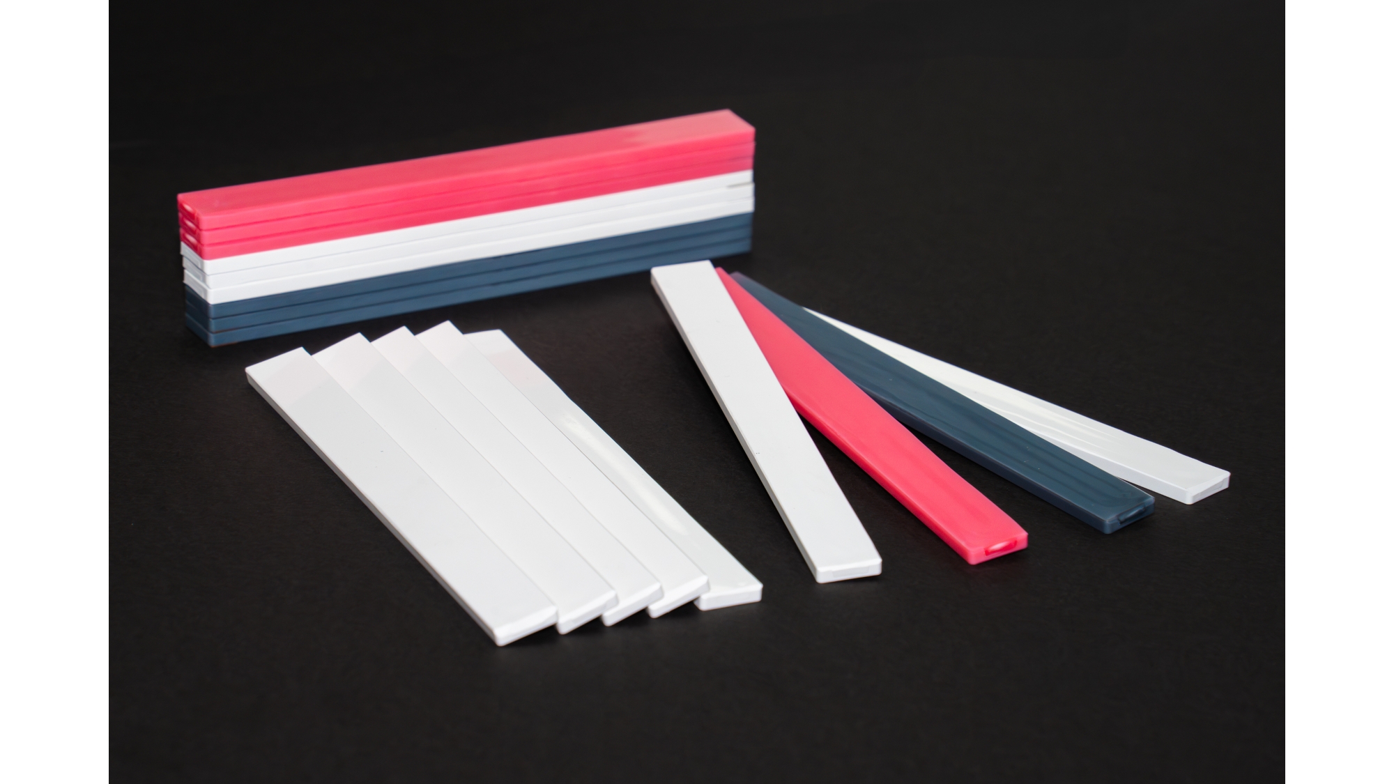

The chemical company's material has gained world-first V-0 level flame retardancy performance certification.LG Chem
LG Chem's PFAS-Free flame-retardant PC/ABS material, made from recycled plastics, received the V-0 rating in the standard flame-retardant test UL 94 for UL certification in the US.
PC/ABS, a plastic that combines polycarbonate) and acrylonitrile-butadiene-styrene, significantly enhances heat and abrasion resistance.
The V-0 rating is the highest level of flame-retardant performance in the industry, requiring the material to extinguish within 10 seconds when a flame is applied vertically. LG Chem is the first to certify a V-0 level or higher flame-retardant performance with a PFAS-free PC/ABS material.
