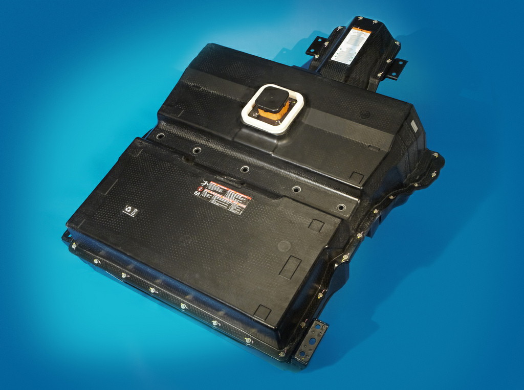

But the 2014 Spark EV, which had a limited release last year, is also important from a plastics technology perspective.
It features the first industry application of a VOC-free, seven-ply vinyl ester/rove cloth composite battery enclosure. Traditional materials that would have been used for the application, either steel of aluminum, were too heavy, according to Kestutis Sonta, a General Motors' materials engineer.  He estimates that the composite enclosure cut weight more than 40% compared to metal systems.
Selective pattern layups are used for localized reinforcement within the complex compression molded shape. The parts are produced by Continental Structural Plastics (Auburn Hills, MI) with vinyl ester resin supplied by Cytec.   The toolmaker is Century Mold and Tool (Elk Grove Village, IL).
Sonta said the composite technology is also being evaluated for other applications in the car such as load floors and structural components.
"The composite enclosure protects the major battery components in the event of a catastrophic event," said Sonta. "The enclosure is nonconductive in nature and protects the occupants and first responders to the accident scene."
The composite used in the Spark does not have the styrene emissions normally associated with SMC/BMC thermoset composite materials, according to Sonta.
"This application was heavily influenced by the USCAR Automotive Composites Consortium project for the Structural Composites Underbody, which allowed us to achieve rapid implementation."
