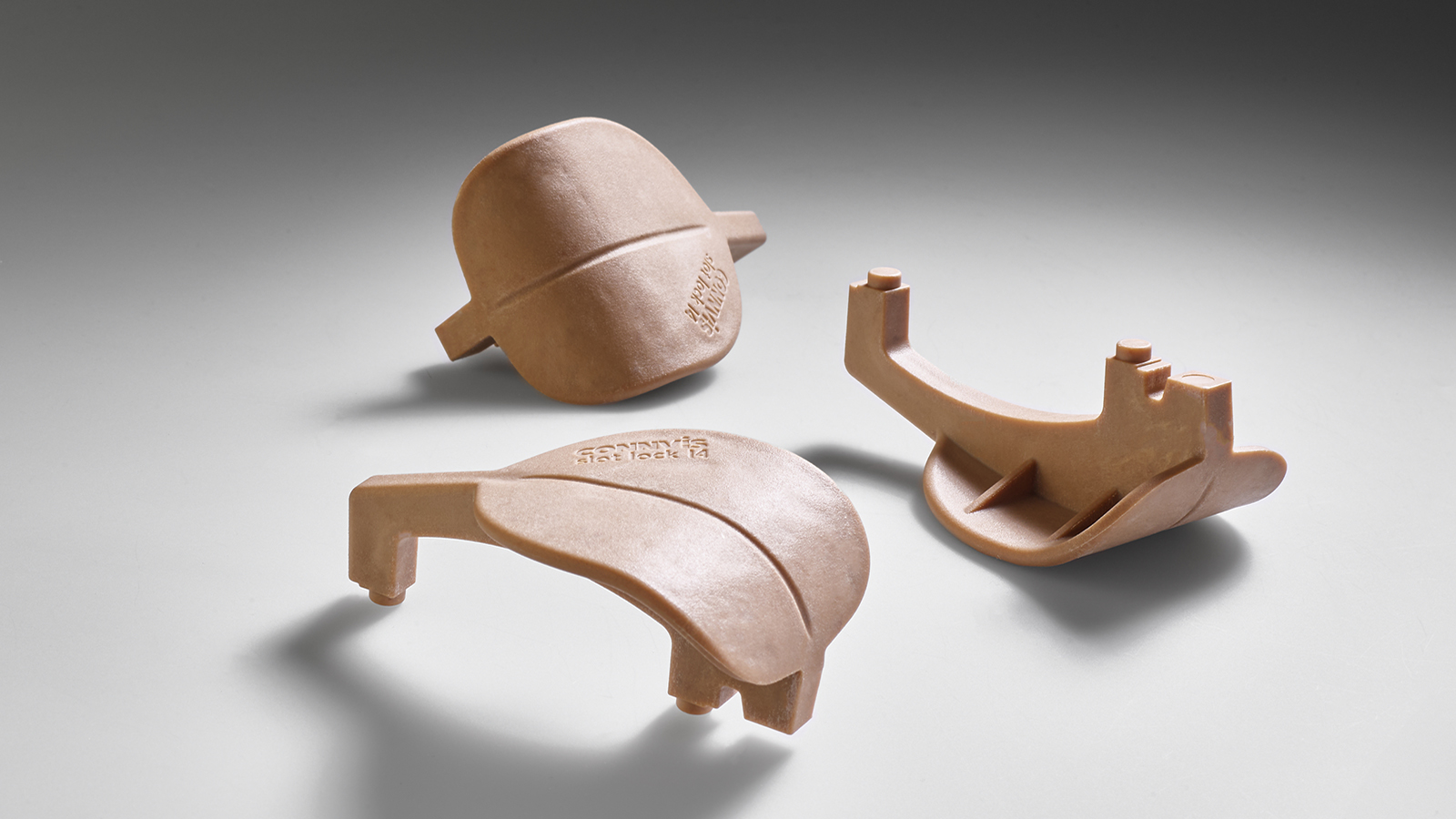

Paper “pearls” replace plastic pellets in a novel injection molding application on the Arburg stand.

Paper-based molded parts
So-called paper pearls take the place of plastic pellets in the injection molding process, paving the way for paper fiber–based products in a range of industries, notably the furniture business, said Arburg. At Fakuma, the press produced positioning tools for furniture connectors, which are typically made from plastic.
Compostable after use
The process was developed by Arburg in partnership with paper and cardboard producer Model. The pearls contain more than 50% fiber content, composed of new or recycled paper combined with bio-based and biodegradable plastic to make them injection moldable. Because of the high fiber content, end products should have a minimum 3-mm wall thickness. They are compostable after use since they contain no additives that could interfere with the composting process, said Arburg.

At the Arburg stand in hall A3, a two-cavity mold from Lercher was used to produce the parts in a cycle time of about 60 seconds.
