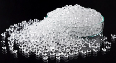

Genioplast Pellet 345 silicone additive lowers the hardness of thermoplastic polyurethane elastomers parts while simultaneously boosting the surface properties. The plastic articles can be given a silky-soft surface that additionally offers greater resistance to abrasion and contamination. (Photo: Wacker)
