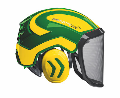

“We already had very good experience with a thermoplastic elastomer from  Kraiburg TPE that was used for the visor of the Protos Integral Safety Helmet,” adds Martin Greber, head of development at Westcam. “The TPE in that device serves as a cushioning and sealing lip on the inside of the visor. It’s combined with the edge of the visor, which is made of polyamide, using multicomponent injection molding. The adhesive strength of this hard/soft application has already been tried and tested many times in practical use, and that was why Thermolast K was also shortlisted for the wire/TPE and ABS/TPE combinations in the headset from the start.”
