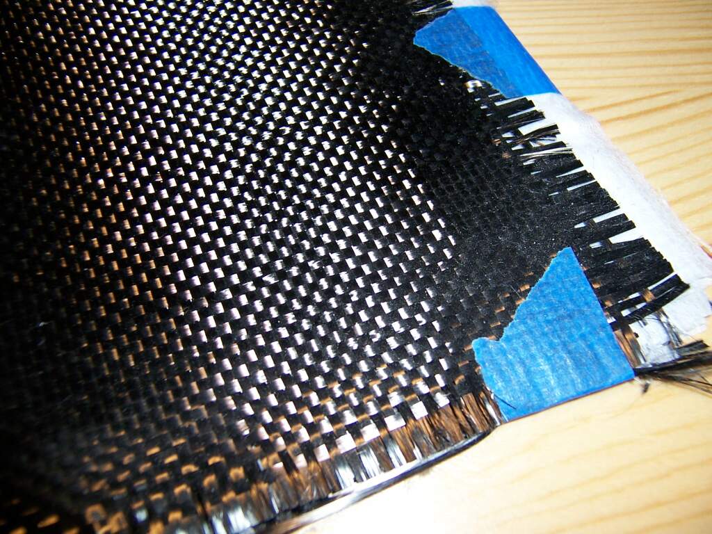

CFC_lo_res.jpgSugars from non-food biomass could one day be converted to acrylonitrile, a key raw material for carbon fiber.“Carbon fiber is a strong, lightweight material that can replace steel and other heavier metals. Current production methods have limited its use, but by leveraging these renewable sources, we may be able to broaden its use, potentially improving performance of fuel-efficient vehicles and renewable energy components such as wind turbine blades,” said Michael D. Johns, Vice President of Engineering for SRI.
