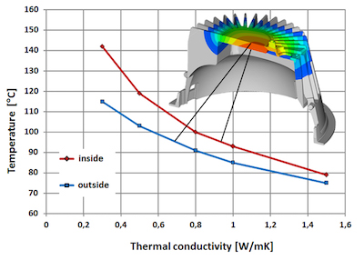

Lanxess supports customers in their development of thermally conductive plastic components with a wide range of services under the brand name “HiAnt”. “For example, we analyze where areas of maximum heat in assemblies occur – known as hotspots – and provide suggestions regarding which components are best designed to dissipate heat. In addition, we also advise customers with regard to the selection of the most appropriate material, offer design suggestions, and simulate thermal conductivity behavior,” explains Boden.
Through this, experts from Lanxess help optimize component design so that areas affected by heat are positioned as far outward as possible and heat dissipation is increased, for example through the use of cooling fins. Furthermore, the company draws up guidelines for designing the components that take the particular characteristics of highly filled materials into account as far as their mechanical properties and processing is concerned.
