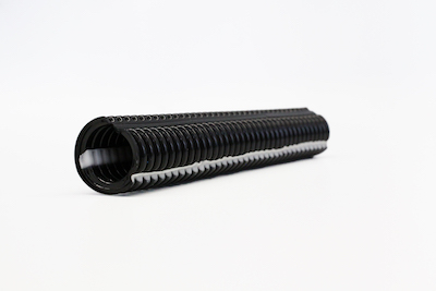

A new type of Polyflex corrugated tube for cable management systems in vehicle construction, which is co-extruded combining polyamide and a thermoplastic elastomer from Kraiburg TPE that provides outstanding temperature resistance, processability, adhesion and surface quality. [Image: © 2019 Schlemmer]
