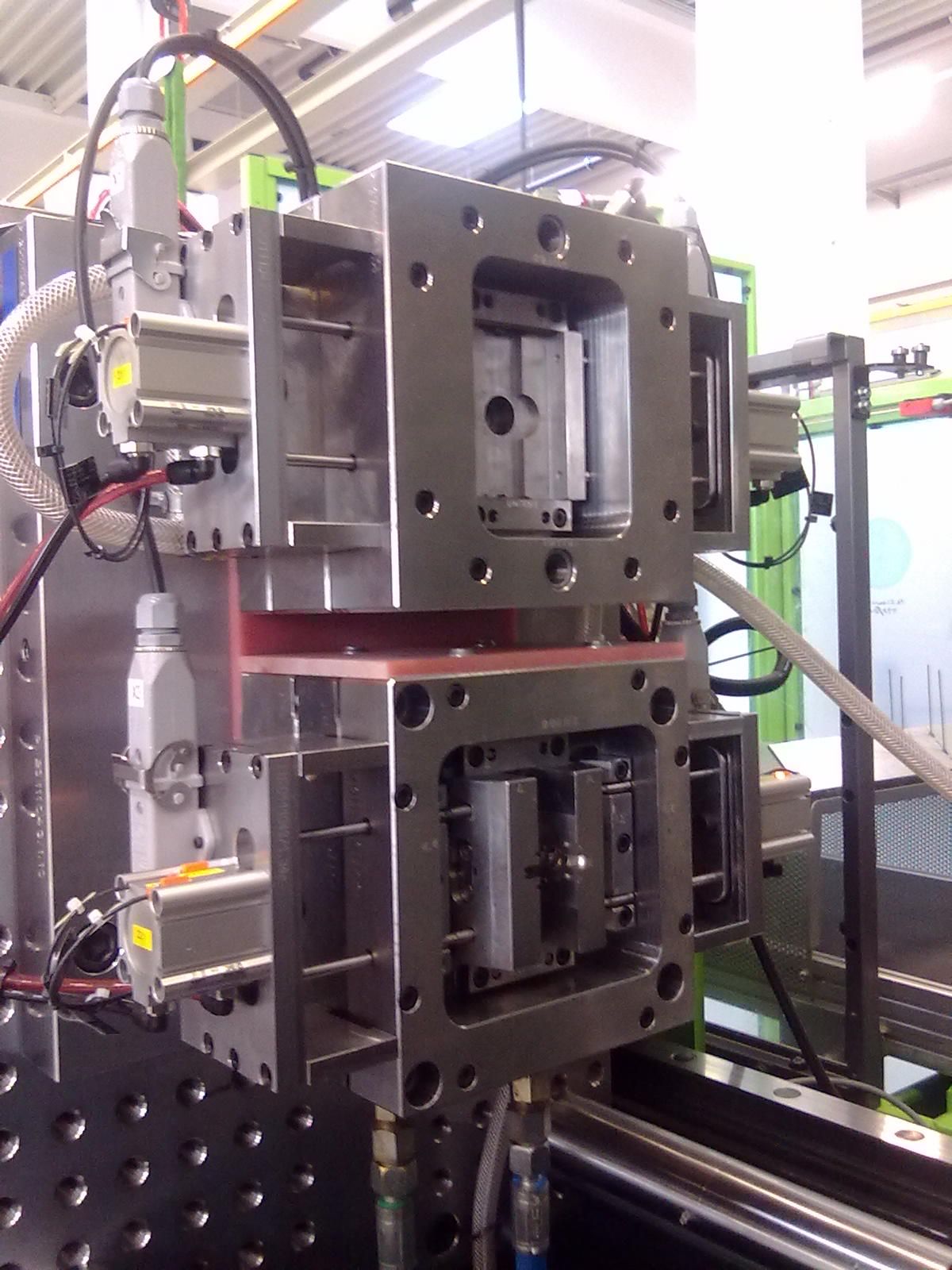

UV lamps are integrated into Elmet mold shown on an Engel injection molding machine.

Silicone elastomers used in two-shot applications typically are cured by heat or at room temperature using crosslinking processes such as peroxide cure, hydrosilylation cure, or condensation cure. In the new approach, newly developed materials are cured with UV light with a UV sensitive curing system that is integral to the Elmet mold.
Application of the technology to injection molding is brand new.
In the traditional process, a standard LSR for injection molding can be cured at around 356-392ºF. However, curing temperatures need to be reduced for large parts so that molds can be filled completely and to eliminate trapped air. Examples are insulators, cable joints, cable terminations, or surge arrestors. The new process shown by Elmet and Engel requires a "UV transparent" mold. Examples of materials that can be used in place of steel are quartz glass or acrylic.
In the demonstration at last month's Symposium, polypropylene was overmolded with liquid silicone to produce wine stoppers. The irradiation time for the vulcanization of the silicone components took 20 seconds.
