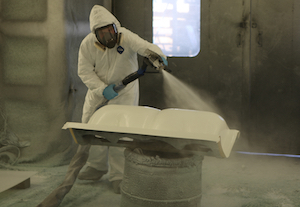

AroStruct can be used with a chopper-mounted spray gun to make parts,
molds and prototypes in minutes.
The resin substitute dries within 30 seconds and cures within 60 minutes. It can be used with a chopper-mounted spray gun to make parts and even molds or prototypes in minutes. Because choppers cut the fiberglass strands to the desired length and throw them in front of the polyurea resin leaving the spray gun, productivity is improved. The polyurea resin attaches to the chopped fiberglass strands and lays into the mold of the fiberglass part being manufactured. The technology is increasingly used by a maker of lightweight, tow-behind trailers that ran afoul of California regulators.

NestEgg Trailers made a fender mold in minutes with AroStruct.

Spraying is achieved with a plural component spray gun connected to a long heated hose and pump machine. Unlike epoxy, which has a short pot life, the structural polyurea’s components are mixed in the spray gun nozzle during application, so there is no pre-mixing needed and essentially no waste in the process, according to VersaFlex.

To boost productivity, Austin mounted a fiberglass chopper on the spray gun. “Since the structural polyurea is so easy to apply with the spray gun mounted chopper and dries so quickly, we’re making product in about one-tenth the time we used to previously,” says Austin.

“When we first made a fender mold with AroStruct, we made the mold in minutes and it works flawlessly,” says Austin.
According to Austin, he used his vendor’s powder-coated steel fender as the mold’s plug, or mold master part. “We simply waxed the part, put clay in any pockets or holes, then sprayed the fender with just the structural polyurea. When that dried within 30 seconds, we peeled the piece off the painted fender surface and had our mold.
“While more complex molds still require a cage around the part, we can make a mold in about one to two days that would typically take one to two months using traditional resin,” said Austin. “We no longer have to wait years to recoup the sky high cost of traditional moldmaking.”
