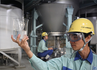

Turns out that these less glamorous CNFs, measuring 3 to 4 nanometers in diameter, are excellent reinforcing fibers for composites, but have proved challenging to manufacture. That’s changing now with Nippon Paper Industries building the world's largest commercial-scale CNF facility in the quake-ravaged city of Ishinomaki, in northeastern Japan, with an annual production capacity of 500 tonnes. The unit is scheduled to commence operations in April 2017.
Nippon Paper Industries has been developing CNF manufacturing technologies since 2007, and installed a demonstration facility with an annual production capacity of 30 tonnes at the Iwakuni Mill (Yamaguchi Prefecture) in October 2013. Besides plastic nanocomposites, Nippon Paper has also developed and commercialized sheet products fabricated from CNFs functionalized with metal ions to deliver antimicrobial and deodorizing functions
