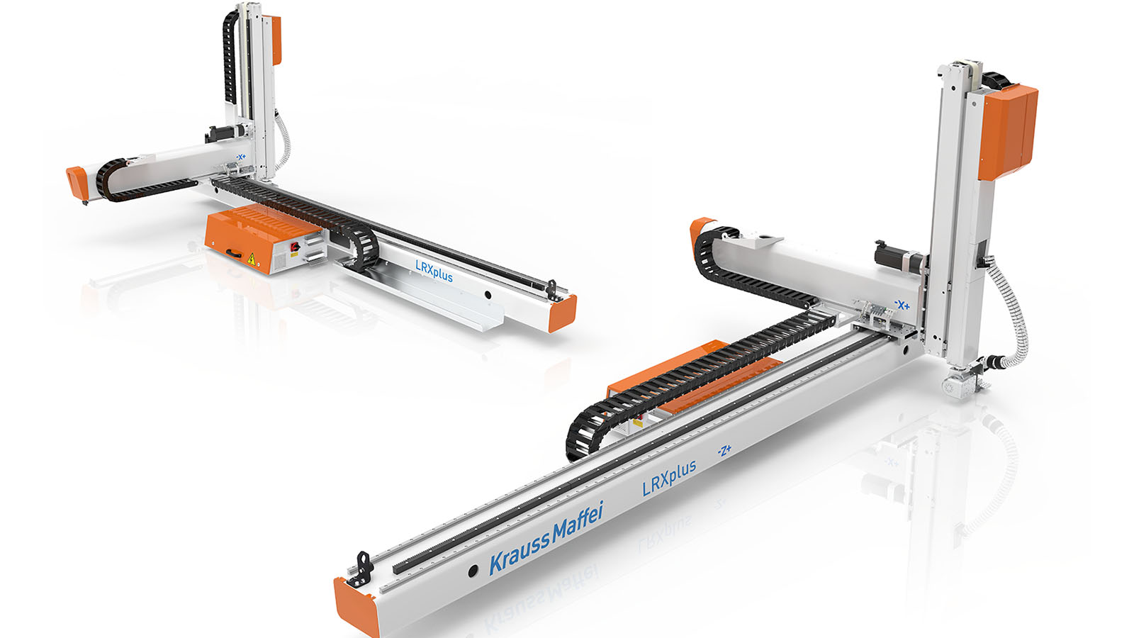

LRXplus linear robots
New LRXplus linear robots from KraussMaffei are compatible with all peripherals.Image courtesy of KraussMaffei

KraussMaffei’s new LRXplus linear robot feature interfaces compatible with injection molding machines (IMMs) from other manufacturers in addition to their own. Demonstrations in hall A7, booth 7307 will be conducted in a multi-component application on an all-electric PXZ 121; a stand-alone version will serve visitors from a popcorn machine. Advances beyond the original LRX series include:
  • Traversing axes with new profile geometry made of crash-resistant aluminum or steel;
  • the new MC7 control with freely configurable operating buttons, and an improved teaching function allowing the desired movement sequence to be implemented quickly;
  • new 10-inch multi-touch display.
