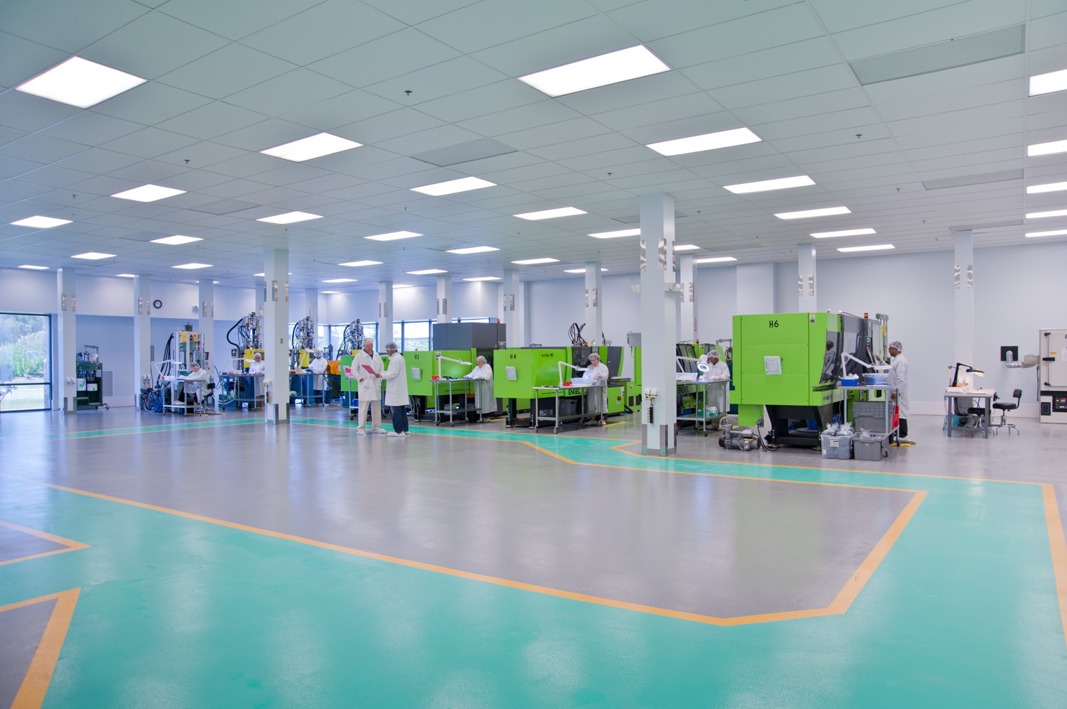

Open floor plan boost efficiencies at G&F Medical.

G&F Medical operates 10 molding machines. The two machines bought this year were 55- and 110-tonne electric Engels for LSR molding. The company has 30 employees, up from 20 when the new plant opened in 2009.
The new facility has an ISO Class 8 clean room with the flexibility to add modular Class 7 or better clean rooms for special assembly projects. It has an open floor plan to improve production efficiency. The company is ISO 9001:2008 certified and is working to become ISO 13485 certified next year.
