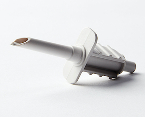

The first glass-fiber-filled ABS from materials supplier Ineos Styrolution (Frankfurt, Germany) that complies with a full range of regulatory requirements is now on the market in a medical application developed by Fleima-Plastic. Located in Wald-Michelbach, Germany, Fleima-Plastic provides contract molding and other plastics processing services primarily to medical device OEMs. A global manufacturer of ABS-based spikes and caps, Fleima-Plastic closely collaborated with Ineos Styrolution in developing the material for medical applications.
The Novodur HD M203FC G3 material is being used to mold medical spikes at Fleima Plastic.
Since it is being used to manufacture medical spikes in this instance, a key property of the material is stiffness. “Thanks to these special glass fibers, the ABS material has exceptionally high e-modulus and significantly improved compression, bending, tensile and impact strength,” said Ismail Dogru, Key Account Manager, Fleima-Plastic.
But that is only part of the story: Novodur HD M203FC G3 was designed to meet the strict regulatory requirements of USP Class VI, parts of ISO 10993 (biocompatibility) and various food contact standards, according to Ineos Styrolution. Because the material is compliant with healthcare regulations, achieving regulatory approval for end products made with the material can be accelerated, noted the company. “We are providing medical device designers with the option to choose a product that meets both technical and regulatory demands,” said Alexander Silvestre, Global Director for Healthcare. "Novodur HD M203FC G3 is the first glass-fiber-filled polymer grade to be offered with the full complement of healthcare compliance documents worldwide,” he added.
