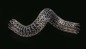

W. L. Gore & Associates Inc. (Flagstaff, AZ) today announced approval of the Gore Tigris vascular stent by FDA. The device, which has had the CE mark since 2011, is a third-generation self-expanding stent with a unique dual fluoropolymer/nitinol design. “Other self-expanding uncovered stent designs on the market typically only use nitinol,” Ray Swinney, Peripheral Interventional Business Unit Leader at Gore, told PlasticsToday. “To the best of my knowledge there are no other self-expanding uncovered stents that use fluoropolymers.”
The device was designed explicitly to conform with the natural movement of the knee when treating peripheral artery disease (PAD).
The dual-component stent is made from a single-wire nitinol stent with flexible and biocompatible fluoropolymer interconnections. “Standard metal stents use metal interconnections, which are much stiffer than the fluoropolymer,” said Swinney, adding that the dual-component design contributes to the flexibility of the device.
The stent is designed to weather biomechanical forces (extension, compression, flexion and torsion) without fractures, even in the most complex anatomies, namely in the superficial femoral artery (SFA) and proximal popliteal artery (PPA), according to Gore. In the U.S. clinical study that supported FDA approval, the Tigris stent was found to have zero fractures, while the control arm devices experienced a 27% fracture rate.
