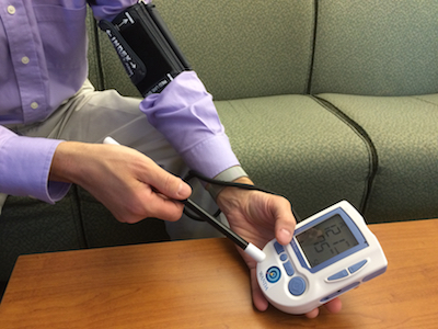

Wave Wanda over a Wi-Fi-enabled medical device and—presto!—it connects with your in-home network andsecurely transmits the data to your doctor's office.Image courtesy Dartmouth College.

Using Wanda, the patient simply points the wand at a Wi-Fi-enabled blood pressure cuff at home to automatically connect with the network and securely transmit the readings to the doctor's office or clinic. There's no need to type in a password to connect the wand—"a lot of people who have Wi-Fi in their homes . . . have no idea what their password is," notes Pierson. Moreover, Wanda does not require specialized hardware in the new device, preshared secrets between the wand and connected device or complex algorithms, add Pierson and his fellow researchers in the paper.
The prototype consists of a ruler with two antennas attached to it, writes Phys.org. "It can acquire a network name and password by being plugged into a Wi-Fi router, and is then detached and pointed at the medical device to connect it to the network. The password information is converted into binary code—ones and zeroes—with one antenna transmitting information packets containing the "ones" while the other sends the "zeroes."
"Because the medical device is close to the wand, it can tell which packet came from which antenna based on the signal strength and can reconstruct the information. But a hacker farther away couldn't tell the difference," explains Phys.org.
