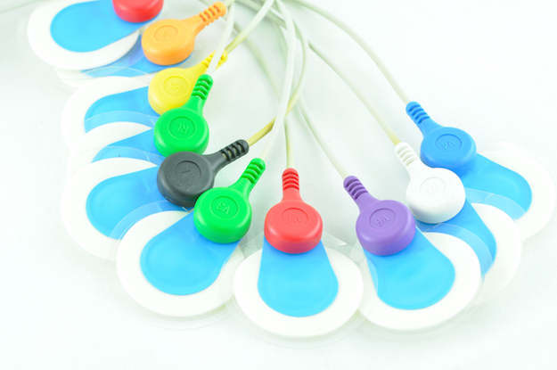

New silicone PSAs from Dow Corning
Dow Corning launched a new family of silicone pressure-sensitive adhesives (PSAs) designed to address issues commonly associated with acrylics. The MG-2XXX series of PSAs enable strong, conformable adhesion of medical devices over extended wear periods without irritating the skin. The new PSAs are also gas and water permeable.
Available in a range of tack and peel-adhesion values, solvent types and solid contents, the four material grades have successfully passed biocompatibility testing for cytotoxicity, skin irritation and skin sensitization, per U.S. FDA guidelines.
The MG-2402 and MG2502 PSAs can be processed using conventional roll coating equipment for solvent-based systems. The MG-2410 material can be applied by means of hot melt coating equipment, and the MG-2401 grade is designed for applications where the liquid adhesive is brushed or sprayed onto the skin.
The MG-2XXX series of silicone pressure-sensitive adhesives from Dow Corning are designed to be gentler on theskin than acrylics.
