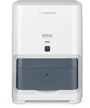

Three materials from Sabic are used in the fabrication of a chemistry analyzer from Idexx.

The Catalyst One chemistry analyzer marketed by Idexx (Westbrook, ME) is designed for veterinary offices. “It used to be made of metal,” said Hermans, “and by designing it in plastic, we were able to take out weight and make it more portable so that it can be wheeled around the office.” Injection molding also enabled a substantial reduction in assembly operations. “The company was able to replace an assembly that required 13 separate parts with a single plastic component,” he noted.
Idexx selected a high-modulus, 40% glass/mineral-filled Noryl resin for the chassis, which allowed the company to achieve the aforementioned part consolidation as well as 63% weight reduction and 77% material and assembly cost reduction, according to Sabic. Cycoloy resin was selected for the enclosure because of its chemical resistance and processability. As for the drawer and lift drawer, which require repeatable, smooth operation, an FR-rated Lubriloy compound with inherent lubricious properties was chosen.
