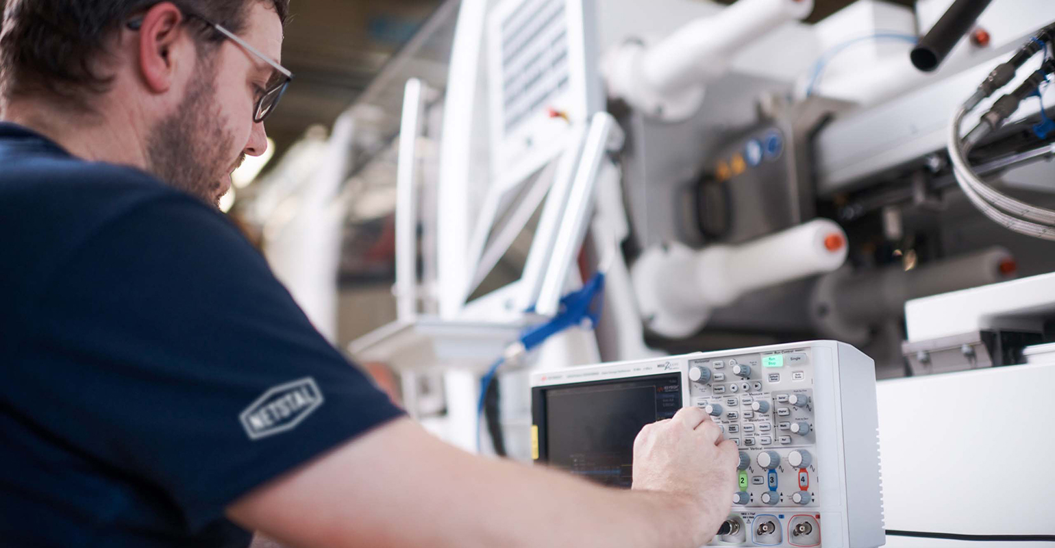

Netstal technician calibrating injection molding machine
Image courtesy of Netstal

Calibration in accordance with ISO 17025:2017 is available immediately, said Netstal in the news release, and can be performed on-site at the customer's premises. "Our new service offering is primarily aimed at our customers in the medical technology sector,” said Daniel Wipfli, Product Manager, Controls and Digital Products. “With risk-based calibration by our qualified calibration personnel and the use of traceable and calibrated measuring devices, we ensure verifiable measurement accuracy of the relevant sensor signals within a defined measurement uncertainty range.” The company’s medical technology customers gain a competitive advantage in terms of quality and accuracy. "In the course of the calibrations, our technical experts create standard-compliant documentation that our customers can use in an audit," added Wipfli.
